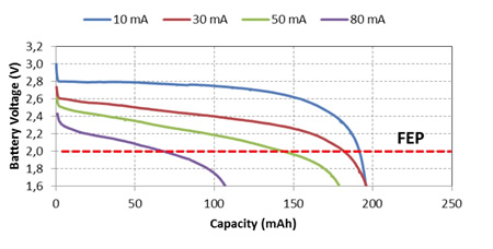

    FEP (Functional End Point) 전압
    • http://www.low-powerdesign.com/121312-article-extending-battery-life.htm

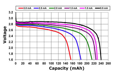

    CR2032 coin cell continuous discharge battery voltage curves
    Figure 2. Peak current magnitude impact on battery capacity for CR2032 with a 25ms pulse cycle
    • https://learn.adafruit.com/low-power-coin-cell-voltage-logger?view=all
